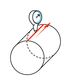

Gauging / Measurement:
Surface:
A part is constrained and a gage measures along a straight line. In this example, the height variance is measured to see how flat or straight the line is along this surface.
Straightness Surface Gauging
