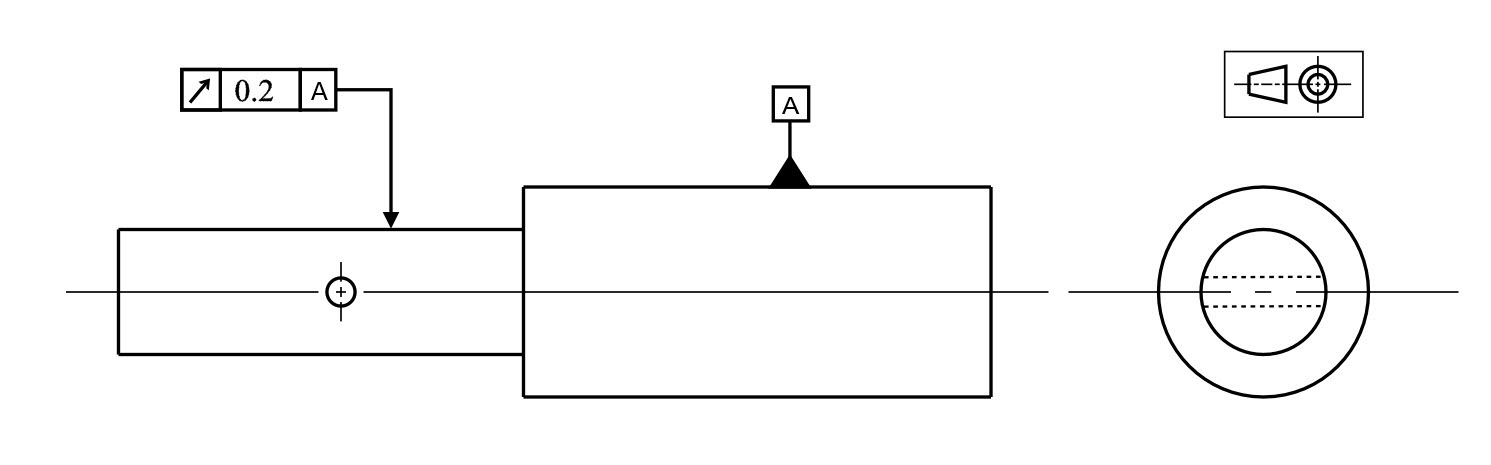

Drawing Callout:
runout drawing callout

A shaft that is rotated at very high speeds is prone to oscillations if the right edge of the shaft is too far offset from the left side. To control how much wobble this part will have runout is used to ensure that the smaller diameter surface is relatively controlled to datum surface A. To control this without Geometric Dimensioning and Tolerancing would be nearly impossible. The small amount of variation in the shaft, straightness of the shaft, and roundness of the individual surfaces would be unrealistic to control. With runout, you have your final rotational condition that you want controlled without needing to specify unnecessary tight control on the entire part.
Runout Example 1
The best way to constrain this part is with GD&T
By constraining with runout as shown on the drawing you are ensuring that when the shaft rotating, with datum A fixed in housing, the reference surface will not go outside of a perfect central rotation by more than 30 microns. This will ensure that only a limited vibration is made and that both parts will wear evenly. To ensure this condition is met, you must measure the parts with a gage.
Runout Example 2
B is now controlled in relation to A, ensuring a smooth, near-perfect rotational system. Note: this runout must be controlled on any cross-section along the reference surface. You must gage each cross-section separately though (Gaging the entire cylinder at once would be total runout).
