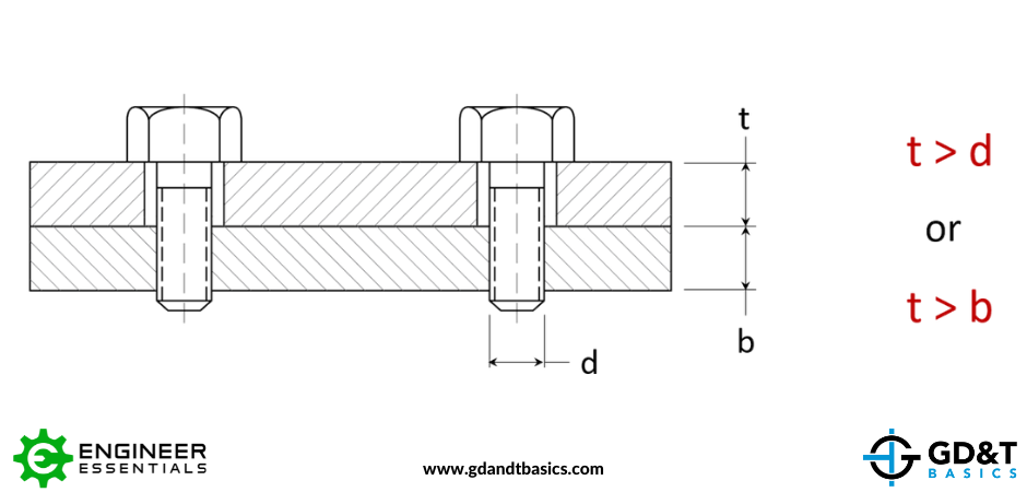

At this height, for both scenarios, the projection of the measured axis for the feature in question must lay within the designated tolerance zone. The projected zone height should always be at least equal to the maximum thickness of the mating part.
There are two rules of thumb for when to apply or not to apply the projected tolerance zone symbol to a feature. First the symbol should be applied when a mating part with a clearance hole has a thickness greater than the diameter of the bolt or pin being used. And second, the symbol should be applied when the thickness of the mating part (clearance hole) is greater than the thickness of the bottom part (tapped hole).
