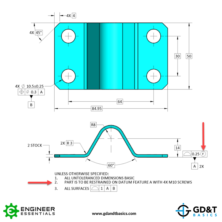

Applying the Free State Symbol to a Restrained Part:
The Free State Symbol is comprised of the capital letter “F” circumscribed by a single circle. It is to be applied to a feature via the Feature Control Frame associated with that feature. The symbol is placed after the value for the tolerance zone size.
As previously stated, by default all parts and their features are to be assessed in their free state. However, it’s often necessary to add a note to a drawing that applies a restrained condition to the part. Often the restrained state mimics the state the part will reside in when it is in its final assembly state. See the note below requiring the part to be restrained to Datum Feature A.
To ensure the profile of the two surfaces is inspected in its free state or unrestrained, the Free State symbol has been applied. For this example, the two surfaces indicated by the profile control will be inspected in their free state, while all other surfaces as well as the position of the 4 holes will be inspected in a restrained state as indicated by Note #2.
