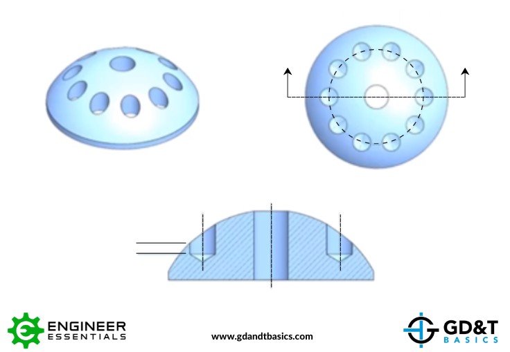

If the depth dimension isn’t clear because of a curved or complex surface, the part should be dimensioned pictorially, without the depth symbol. The part in Figure 2 is a good example of this. Because of the curved surface, the depth measurement would be unclear without a section view indicating where the depth is to be measured from.
Figure 2: Part with a Curved Surface
